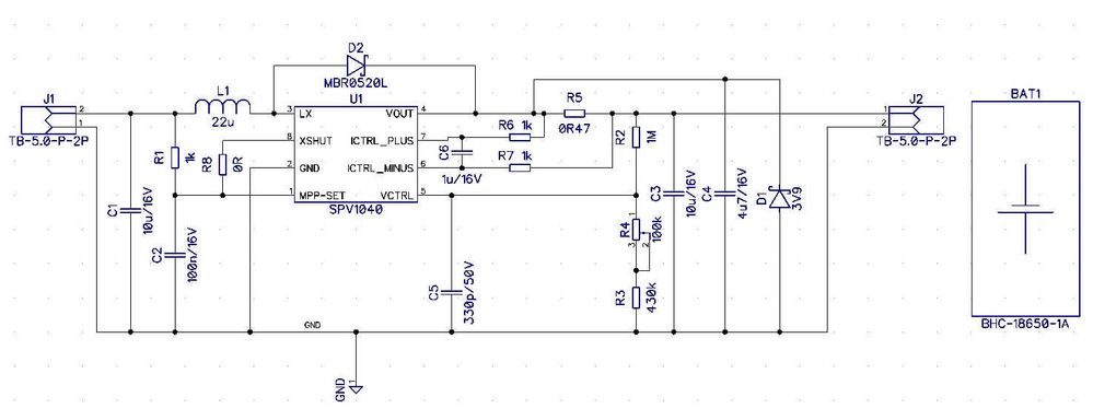

Hi.
I designed the power converter which is supply from the photovoltaic cell ( Umax = 5.5 V / 1 W) on a SPV1040. The problem is that the system did not stabilize the output voltage.The output voltage is proportional to the input voltage. I attach the schematic:2016-08-30 10:43 AM
I forgot to add that I no soldering diodes D1 and
D2. :)
