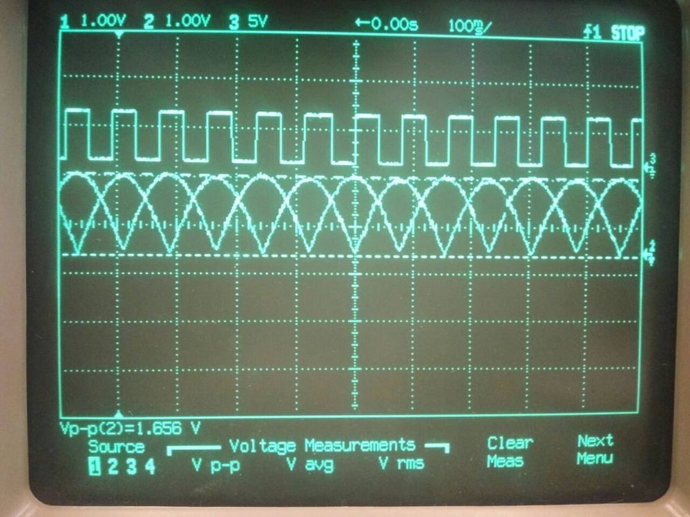

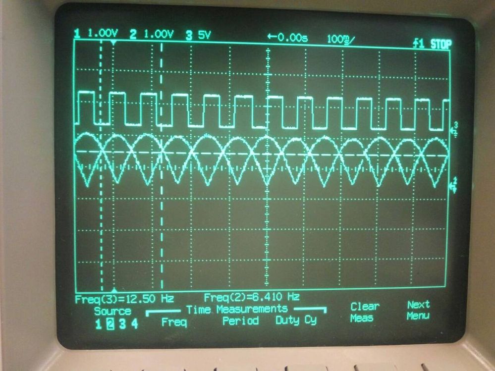

I am trying to implement microstepping on a X-NUCLEO-IHM05A1, which i am using with an Arduino uno. I have followed the microstepping application note, and i obtained the right waveforms at l6208 references' input pins. Here you can see the waveforms obtained with my oscilloscope. Of couse the sinusoidal waveforms have been probed at the onboard low pass filter's output. 1 and 2 are respectively the waveforms for refA and refB, while 3 is the Clock signal fed to the shield.
