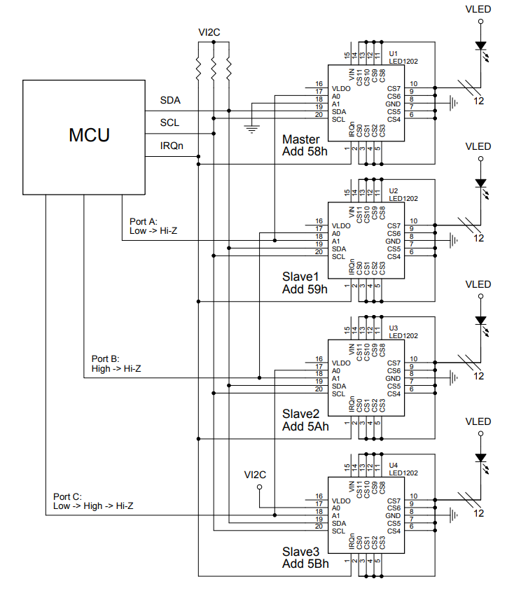

My comment is not specific to LED1202. The issue is that it's nearly impossible to have consistent results when chaining multiple current sinks when they operate digitally (relatively low frequency PWM for example) as the phase between the sinks is generally not guaranteed to be uniform (LED1202 supports phase shifting). Otherwise, here is a screen shot from the datasheet where the current sinks are chained:
