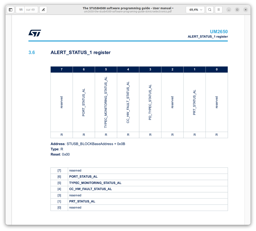

If I have a look to chapter 3.6:
The fields are not documented. For example what are PORT_STATUS_AL and PRT_STATUS_AL?
You can also see that bit 2 is missing in the array and bit 3 is not consistent with the register drawing.

} STUSB_GEN1S_ALERT_STATUS_RegTypeDef;To summarize both (I assumed that the bits description is wrong and used the register drawing):
In bold are "understandable" differences, in bold italic are inconsistancies....
At least CC_HW_FAULT_STATUS_1 and CC_HW_FAULT_STATUS_0 share the same kind of issue.
