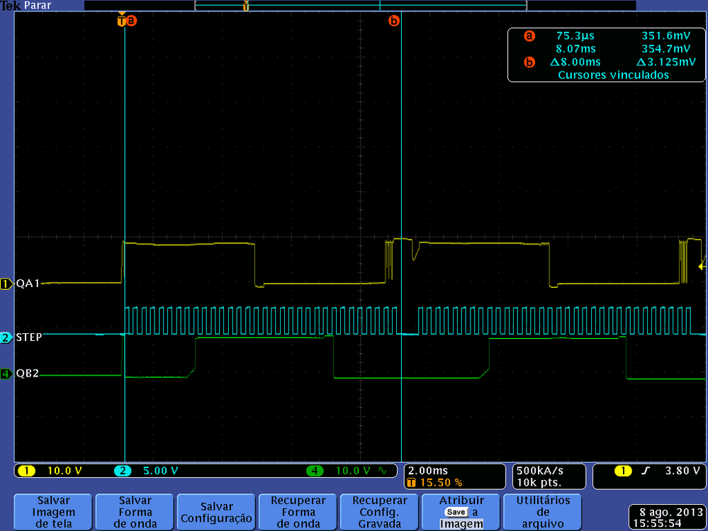

I want to control a stepper motor (
http://pt.farnell.com/astrosyn/163/stepper-motor-1-8deg-5v/dp/9598650
) with L9942 from ST.But i have some problem because the motor dont rotate uniformly (lose some step):2014-02-02 10:41 AM
The STEP signal is an input signal and it should be generated by a microcontroller or by an external circuitry.
Checking the scope-snapshot, the duty cycle of the STEP signal is not constant. this behaviour can be the source of the problem you claimed.2014-07-09 12:22 PM
