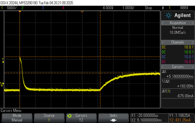

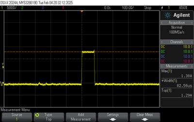

5. I have attached waveform images for your reference
Image1: Motor not turning on, current spike observed for 80us,1.3A max
Image2: Motor turning on after some attempts, but current spile also observed, but duration of peak current is less. This confuses me.
Now i need to change the fan from 0.24A to lower ratings or can i configure in the program itself?

Firstly, I am still confused by the current spike because the motor should be working inductively and its current should increase with the curve, as can be seen on the right side in image 2. Is it possible that the motor contains electronics that cause this spike?

Yes, even I'm also confused with the first waveform, but i suspect it due to the "tdly SCB" , because that 80us in the image 1 is constant in all the observation. It might be because of the program.
