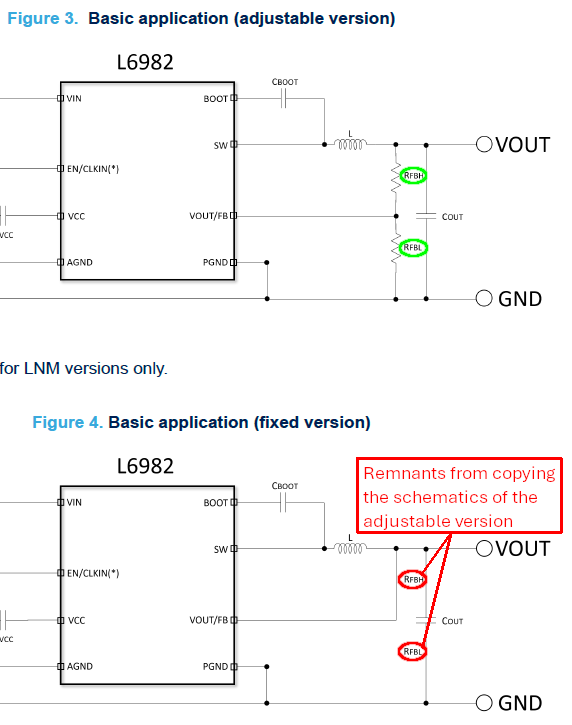

Dear Peter
Thanks for answering, we have removed and shorted the R1~4 and the Value has become normal
However the R_FBH & R_FBL on the user manual is quite misleading, it also shows on the Schematic,
The data sheet for version 1 only contained the adjustable version, later the fixed version was added. The colleague responsible had removed the feedback resistors from the drawing, but unfortunately not their labelling, for which I would like to apologise. This will be corrected in the next revision.
