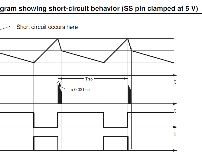

1) At 80V High voltage startup generator will start and upto 15V will build up at Vcc pin. Then high voltage generator will stops and Vcc voltage fall upto 5V (Vccrest) and again high voltage generator will start. Same process will repeat as we increase the supply voltage upto Turn on threshold input supply voltage.
2) At Turn on threshold voltage, IC will works like short circuit behavior similar to attached waveform. As we increase the voltage above to the Turn on threshold, IC works in short circuit behavior. But here SS pin voltage is not verified as 5V mention.
Please don't consider starting part in waveform. please refer below part
3) For very short time, Gate pulses coming, around 1V is generating at output
Questions
1) At above Turn threshold supply input voltage, why Vcc voltage is not staying above Vccoff(10V). It is discharging upto 5V as shown in above waveform.
