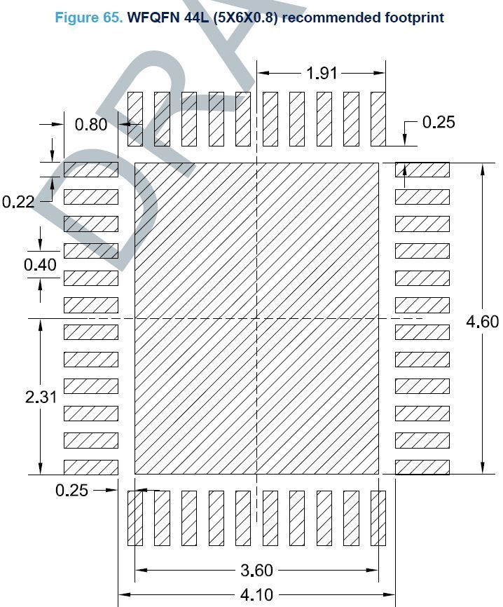

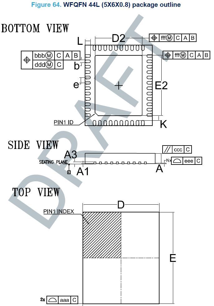

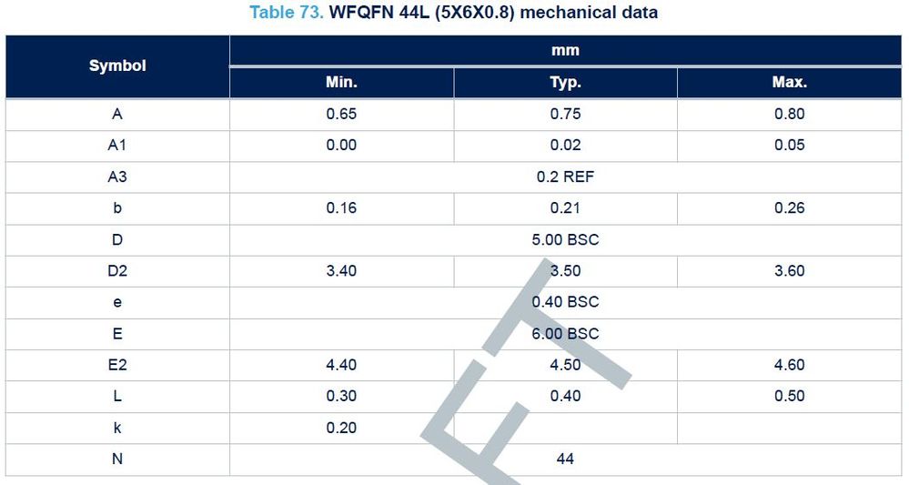

STPMIC1 Datasheet is planned to be published soon (probably before end of this month).
Find attached extracted figures for STPMIC1 package.
You could also extract STPMIC1 PCB information from published projects/gerber of e.g STM32MP157C-EV1 or STM32MP157C-DK2
