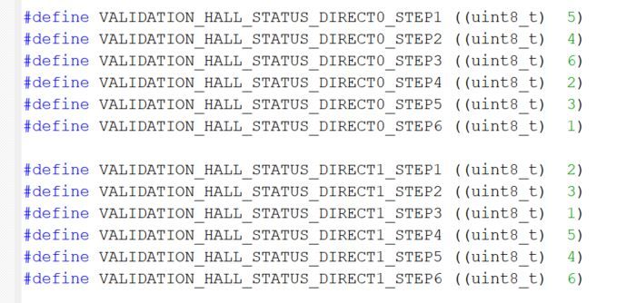

that usually happens when expected sensor status doesn't match with acquired status.
This may due to either a wrong connection or a wrong Hall sensor decoding table.

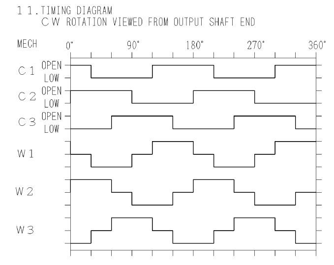

Supposing that all the connections are OK (phases U, V, W and signals H1, H2, H3), I suggest you to have a look to the decoding table included in the file 6step_synch_hall.c and here above attached. This table gives the correspondence between hall sensors status and step. For your understanding, steps and sensor status are defined as indicated in the manual of motor Shinano LA052 (also attached) where step1 corresponds to W1 high, W2 low and w3 floating, and DIRCT0 is the clockwise directionBeside this, in case that the fault might due to an overcurrent event at start-up, I would also recommend to reduce the PI gains of the speed loop.
