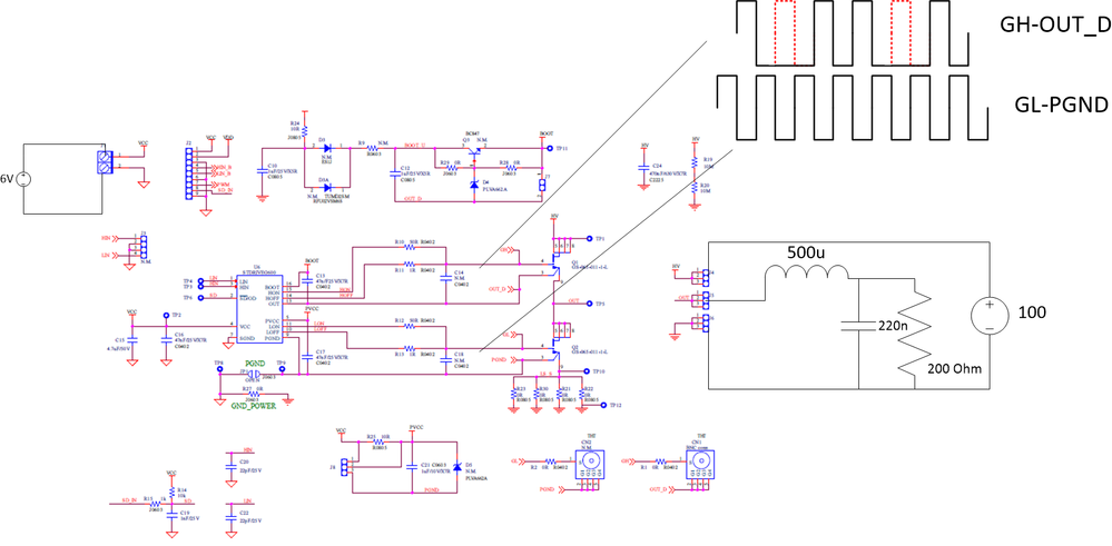

I bought the evaluation board EVSTDRIVEG600DG and I made the circuit in the figure below.
I have the following problem:
with a 50khz pwm signal (Dead Time=200ns) and a duty cycle of 90% with a power supply around 100v, the high side driver of the ic stdriveg600 starts to lose pulses and in general work in bad way.
What could be the reason?
2022-05-16 3:44 AM
I am not able to read it properly due to picture quality.
Whats the value of your Bootstrap capacitors? 47nF?
¿Are they ceramic?¿Are they rated for 2 times your operating voltage(spikes)?
Maybe they are too big? Thus not fully charging in between cycles
2022-05-16 3:56 AM
The bootstrap capacitors mounted on evaluation board are 47nF in parallel with 1uF.
2022-05-16 4:02 AM
im talking about C13 and C17, i dont see any pararell 1uF in your schematic.
If i were you i would try to reduce the bootstrap capacitance values.
2022-05-16 4:06 AM
C21 is in parallel with C17 and C12 is in parallel with C13.
