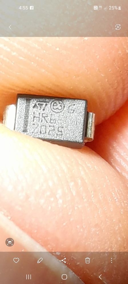

2022-10-04 4:54 PM
ST DIODE HR6
STTH1R06A
https://www.st.com/resource/en/datasheet/stth1r06.pdf
