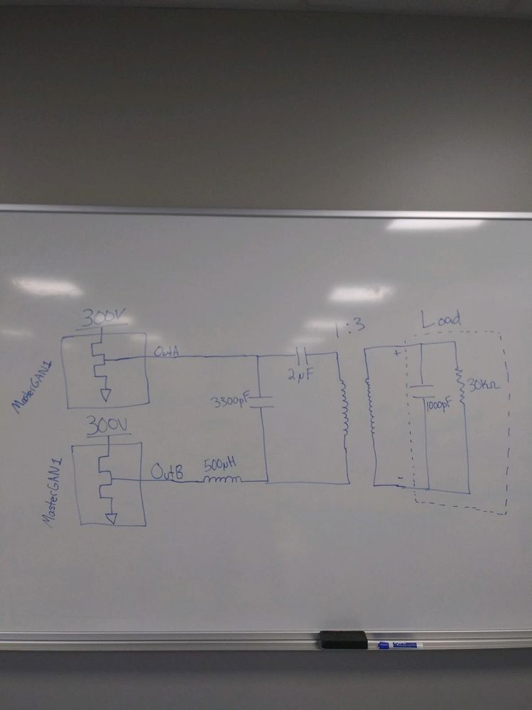

1. We have the 2 boards set up in a full bridge configuration (see attached picture for schematic details)
2. I was monitoring the GH and GL signals with low voltage differential probes at the CN1 and CN2 connectors with the BNC connectors removed
3. The switching frequency is 250kHz and we are generating the PWM signal using known good FPGA code for full bridge configuration, and we are using the high side signal as the PWM signal input and the EVAL board makes the low side signal

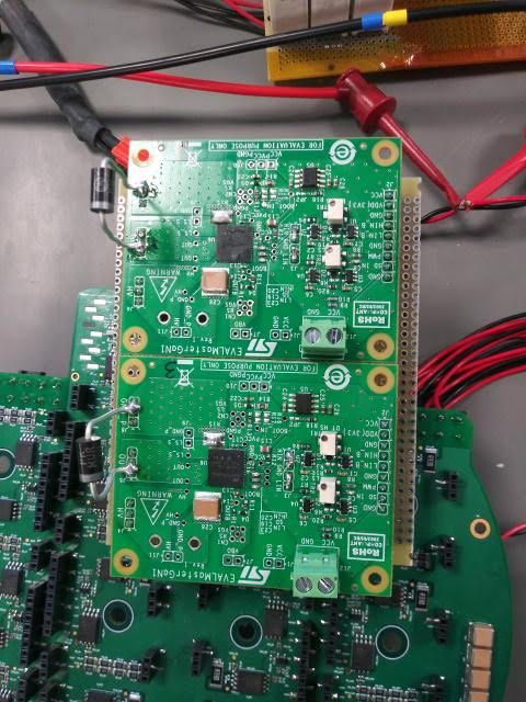

We were able to fix the problem using a negative clamping diode on both of the switch nodes, but we were wondering if you have ever seen this problem in the past. If there is another way of fixing our problem without adding external components, then we are up for suggestions.

Hello @PHenr.1,
The issue seems to be related to a below-ground voltage (BGV) phenomenon experienced by the OUT pins.
Electrically, the OUT pin could safely tolerate even many volts below ground without problems, but the BOOT pin, which is indirectly bound to the OUT pin voltage, cannot.
As reported in the MASTERGAN datasheet (Table 3 Recommended operating conditions) a minimum BOOT voltage (versus GND) is recommended during high-side turn on to allow a proper GaN power transistor turn-on.
Increasing the bus voltage the BGV phenomenon is accentuated, adding external diode you are clamping the maximum negative voltage and keeping the BOOT voltage inside a proper operative range.
