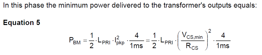

0690X000006DGMeQAO.pngThere is minimum power at burst mode, you must dissipate on secondary side.

If you use PSR, you can use only CV output, so, yes, it is good part for it. Regarding wasting energy, it is dependent on transformer quality (leakage inductance) as well as snubber design, transfer ratio, inductance...
