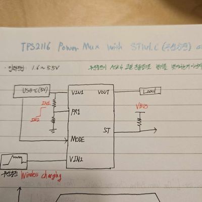

By the way, if you are interested using wireless charging and wired charging both, using power mux and outputs single one, please reply me. I will be very appreciate it.
It seems the wireless charging's output fluctuates so hard so that the power multiplexer cannot handle the drop, and resets in very short term frequently. Of course no output come out.
Below I attatch the simple diagram, any thoughts or ideas please keep me in the loop.
Thank You.

2024-01-21 10:57 PM
It was not the fluctuation nor the STWBC's problem
It was setting high voltage regarding the Mux's input.
When setting Vout 5V → 4.5V , problem disappeared.
