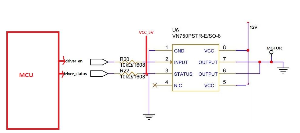

VN750PS-E 드라이버를 통해 모터를 구동하는 회로를 작성하겠습니다.
INPUT에는 5V MCU 신호가 있고 12V 전압이 VCC에 연결됩니다. OUTPUT에는 모터가 연결되어 있습니다.
하지만 STATUS 핀을 처리하는 방법을 모르기 때문에 이런 글을 남깁니다.
데이터 시트에 따르면 Rprot는 10k 크기의 저항으로 연결되며, 그 전에 MCU의 5V가 아닌 전원 공급 장치에서 추가 5V가 나오는데 맞습니까? 누구든지 좀 더 이해하기 쉬운 그림을 말하거나 그릴 수 있습니까?
STATUS 핀을 제대로 연결할 수 없었던 현재 상황을 게시하고 있습니다.
감사합니다.

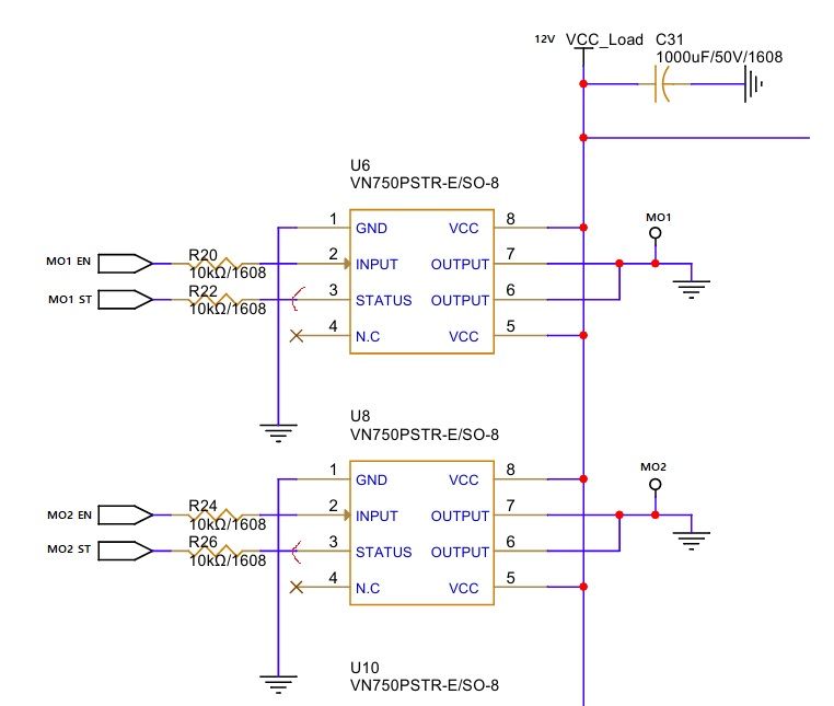

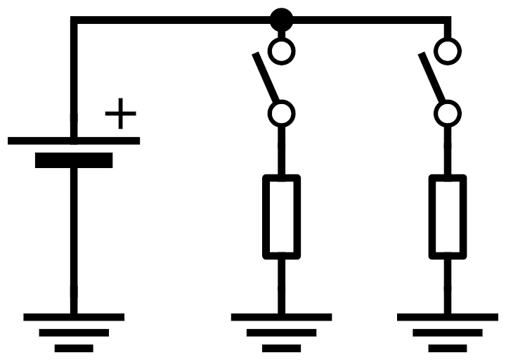

You are absolutely right: a high side switch is connected to the supply voltage to be switched and switches this to the load, which in turn is connected to GND. If you have several high side switches, as in your case, all GNDs are connected together, so everything is correct in your case.
Ground is called ground because it is a common ground. You would now have to carefully explain to your boss that his view is ... ahem... does not quite correspond to the fact. You might ask him for his opinion on a somewhat simplified but exactly similar scenario, which I have illustrated in the following picture. Does a short circuit occur there if you close both switches?

hello
I am going to create a circuit to drive a motor through a VN750PS-E driver.
INPUT has a 5V MCU signal and a 12V voltage is connected to VCC. On the OUTPUT, I have the motor connected.
However, I'm writing this because I don't know how to handle the STATUS pin.
According to the datasheet, Rprot is connected with a resistor of size 10k, and before that an additional 5V comes from the power supply, not the 5V from the MCU, is that correct? Can anyone say or draw a picture that is a bit more understandable?
I am posting my current situation as I was unable to connect the STATUS pin properly.
Thanks in advance.
Your drawing is a bit misleading for the motor, but surely you mean that the motor is between OUTPUT and GND, right?
Pin Status: this is an output that either floats or to which a pull-up resistor is typically connected after 5V. The 5V at the pull-up may well be the VDD=5V of the MCU.
In addition, it may be useful to provide a protective resistor if there is a risk of reverse battery or different GND potentials (see data sheet, section 2.5).
Hope that answers your question?
Regards
/Peter

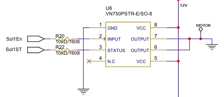

Isn't output the output from the MCU toward the driver?
I tried adding VCC_5V of STATUS pin. Is this the right way?

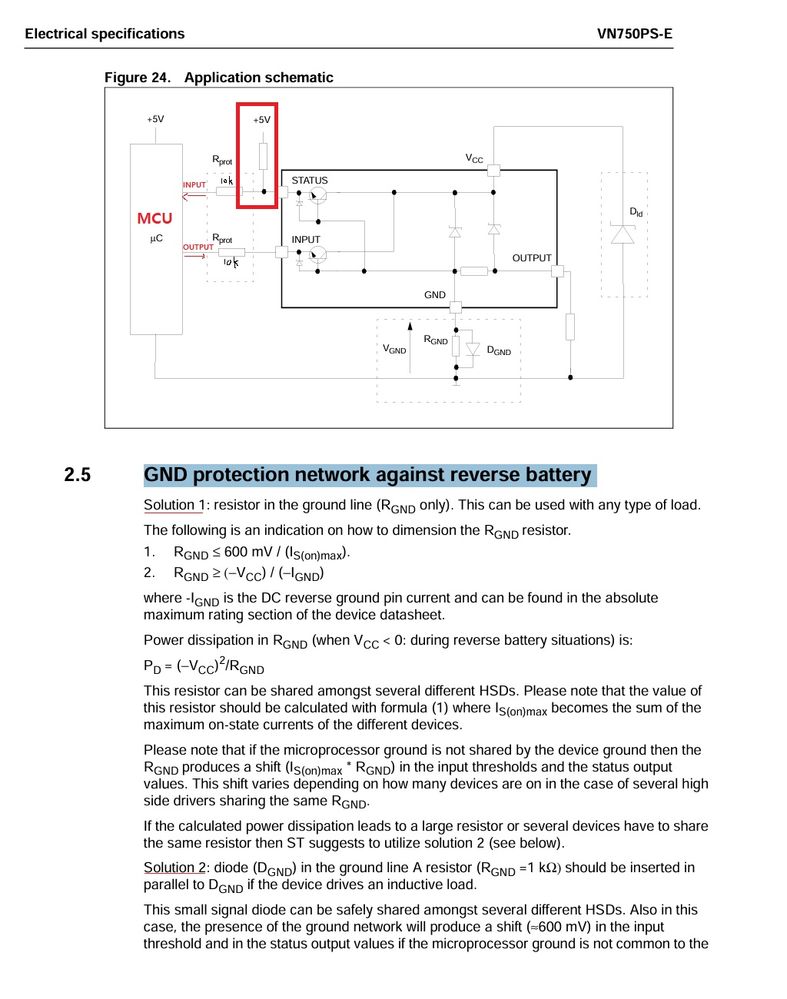

I also saw the part about the reverse voltage protection regarding Ground. I'm still learning it, so I don't understand it right away.
If you look at Solution 1, there is no recommended resistance value for GND
If you look at Solution 2, the recommended resistance value for GND is 1K, right? But Solution 2 says to connect additional diodes in parallel here. If you use Solution 1, what resistance value should you use? The load current would be around 1-2A if it was normal.

Pin 1 (INPUT) is an input and is driven by an MCU output (driver_en in your drawing).
And as I wrote before, pin 3 (STATUS) is an output that must be connected to an MCU input If you connect VCC_5V directly to pin 3 as in your second drawing, this will destroy the STATUS pin and thus the VN750.
I don't know what you mean by Solution 1 and 2. The protection functions are explained in the data sheet, section 2.5 to 2.7.

I marked 5V in the status pin of figure24 and is that way wrong?
Also, as you say, the arrow is the direction of IN, OUT, right?
And I applied 10k to Rprot by applying 2.7 is this right?
Solution 1 and 2 I mentioned is the content of 2.5 (GND protection network again battery). I saw the content, but it was difficult to understand, so I inquired again.
I'm learning for the first time, but I'm not good enough because I'm doing it alone. Sorry.
Thank you, PETER
Peter BENSCH
Well, in your second drawing you had connected Status directly to VCC_5V (which is wrong), while fig 24 shows the pull-up resistor you have now outlined (which is correct).
The arrows shown represent the correct signal direction.
Regarding reverse battery protection, this is important in applications where the battery may be connected with the wrong polarity, e.g. in cars of someone without electrical knowledge. Without this protection, the VN750 could be destroyed by excessive reverse currents. However, if you can rule this out because you have full control over your system as an individual developer, it is not absolutely necessary to install such protection.
If you want to provide reverse battery protection, you can choose from the two variants with or without a diode. Formulas for the resistance range are given for Section 2.5, solution 1. The resistor to be selected depends on the respective application, which is why no resistor is recommended. It is important that the resistors Rprot, the dimensioning of which is described in section 2.7, are also provided for successful protection. Solution 2 with the GND diode is then necessary for inductive loads, as in the case of your motor.
I also recommend reading AN1596.
Regards
/Peter
