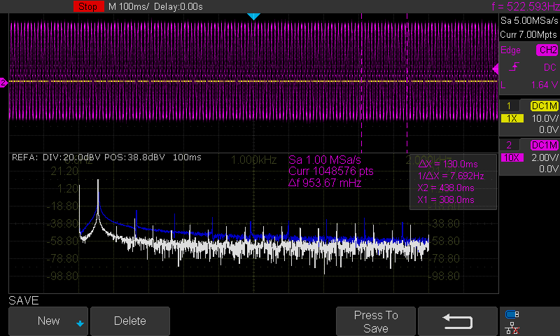

In the frequency domain however, there is a very noticeable difference between the two waveforms. The FFT trace below shows a primary peak at 100 Hz, corresponding directly with the step frequency of 400 sps (4 steps = 1 wave period). In the affected module both odd and even harmonics are present, whereas for the healthy module, only odd harmonics are present.
0693W00000Kb5kwQAB.pngI have experimented with the control system values not to much effect. The pitch of the vibration reduces with reducing RUN current, but is still significantly louder on an affected versus an healthy driver circuit.

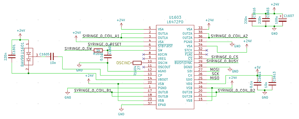

EDIT: Motor driver schematic segment (missing connectors):
We are driving with 24V

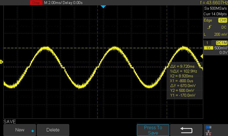

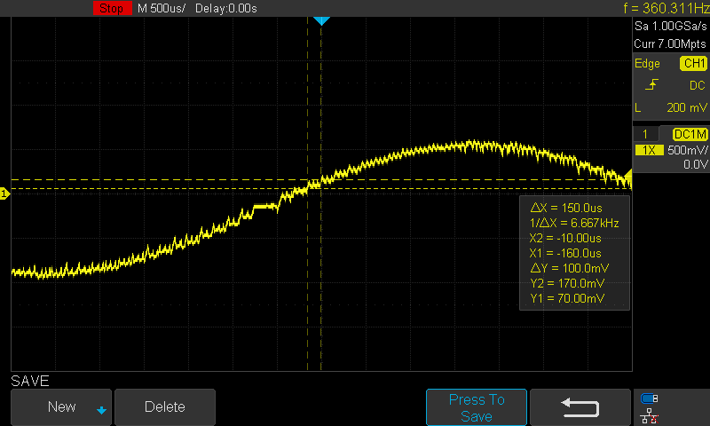

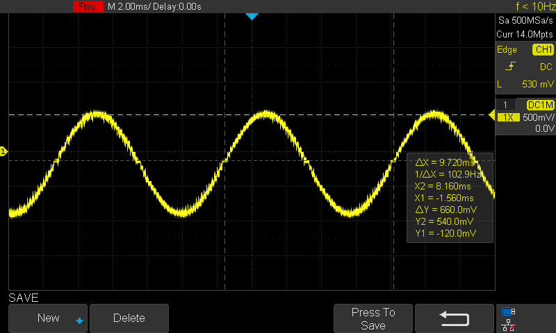

Could you share some waveforms showing the motor current phases with shorter time base?

LWalk.1
Associate II
Here are some waveforms of both affected and healthy waveforms on some shorter time bases.
Affected:
0693W00000KblTsQAJ.png0693W00000KblURQAZ.pngHealthy:
0693W00000KblV0QAJ.png0693W00000KblVAQAZ.pngI've placed the cursors to highlight some features of the waveform in each case.
I only have a single current probe, so I cannot capture both phases at the same time. I have performed the FFT analysis from my earlier post and confirmed the frequency content is the same on both phases, on both the healthy and affected side. I could possibly rig something up to measure with a voltage probe if necessary.

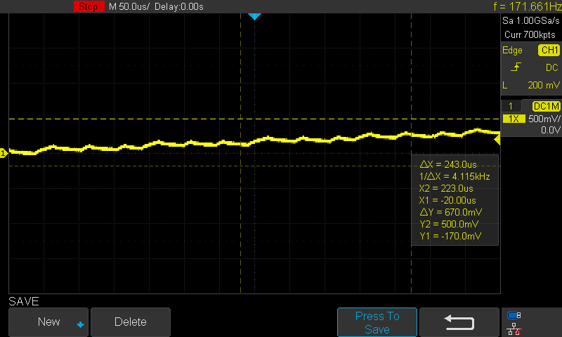

LWalk.1
Associate II

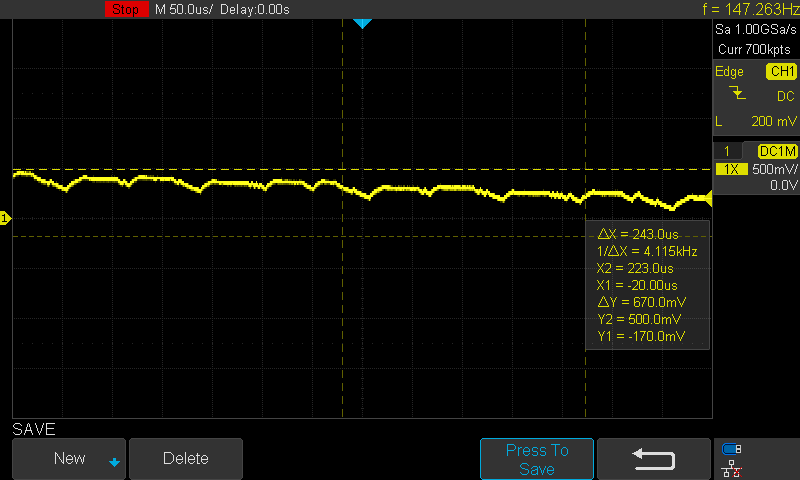

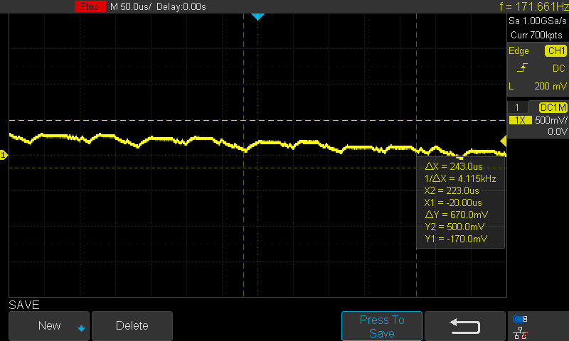

I caught some additional waveforms at a 50µs time base:
affected:
0693W00000KblaFQAR.png0693W00000KblZvQAJ.pngHealthy:
0693W00000KblaeQAB.png0693W00000KblaKQAR.pngThere is an obvious difference between the waveforms in all cases... there is a 50 mV DC offset between the healthy and affected driver. I had been putting this down to slight variations in the position of the current probe (it is a hall effect sensor), but it is very consistent, and I am careful not to move the current probe when I change over the drivers.
EDIT: 50 mV on the scope screen. I'm not quite sure what this equates to Amperes.
Cristiana SCARAMEL
Hi @LWalk.1​,
the current control looks good, so it could depend on a mechanical resonance of the motor.
