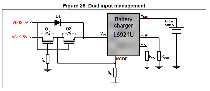

It is possible to have one USB-C port used for charging, and the other USB-C port used for Data transfer (to a computer). But you'll need to design your system accordingly.
- If you want the USB Data (D+/D-) to come from either USB-C port_1 or port_2, you'll need to implement a USB2.0 Data hub.
- If you want the USB-C Power (Vbus) to come from either USB-C port_1 or port_2, you'll need to implement a Power system ORing
Note that the Mosfet controlled by STUSB4500 cannot be toggled manually. If you keep the chip in reset, it will disable the Mosfet, but it will also disconnect from the USB-C Source (so no Data transfer will be available).
Thus you need to implement an external ORing (after the STUSB4500 has enabled the power path).
There is an ORing example on the picture below:
