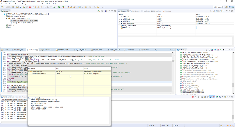

I have successful compiled the FOC AC6 STM32F4xx_UserProject corresponding to my 40V BLDC motor with Hall sensors. However, I always get a Hard Fault during 'MCboot' as shown in the attachment.
I am quite new for motor controlling. Please help me to figure it out how to solve this error. Thank you for your support.

2017-10-10 11:06 AM
I always get the forced hardfault here (as shown in the picture), SPD_Init try to initialize CSPD object (SpeednPosFdbk class).
All code is written in C. How could I check errant pointers?
