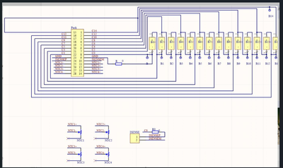

In addition, here is a 14-cell battery pack board schematic that you can connect to BMS connector of the EVAL-L9963E
