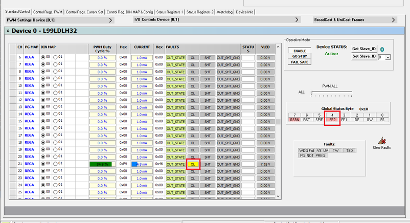

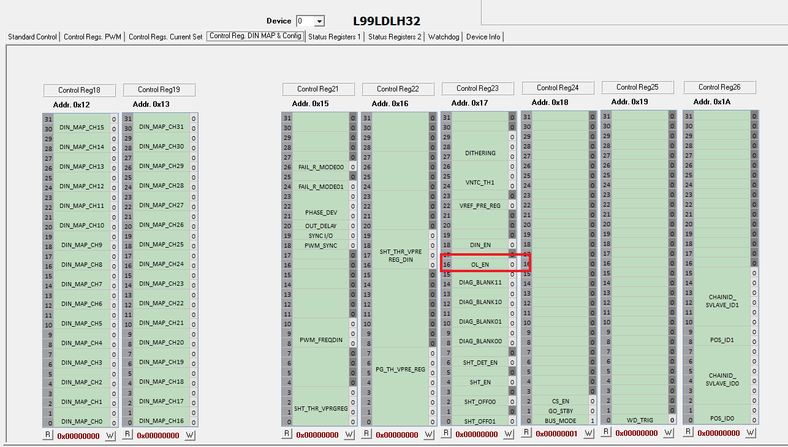

The bit OL_EN is set to "0" as shown in the following image:
But despite this, when I try to activate an output channel, the device indicates an open load fault and the FE2 bit of the global status byte is set to "1".
