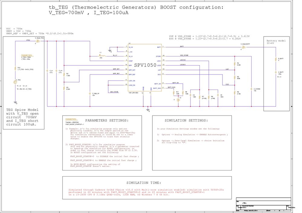

So some random schematic as a screen shot, with poor resolution is the best you've got to work with?
Perhaps cite the source, or the original schematic to provide some context.
If you just have the schematic, expect you might have to work up you're own BOM

Understand that I don't work for ST, and have no idea what you downloaded, from where, or who authored it.

https://www.st.com/en/power-management/spv1050.html .This is the link that I get from ST website. at cad resources platform

@luckysquad As you can also see from the Word document in the ZIP you attached, this circuit was only simulated with PSpice and not physically built. Further documentation is therefore not available, but a BOM can easily be created from the circuit.
BTW: the current version on tab CAD Resources of the product website contains neither the simulation description mentioned nor the PDF included in the attached ZIP.
