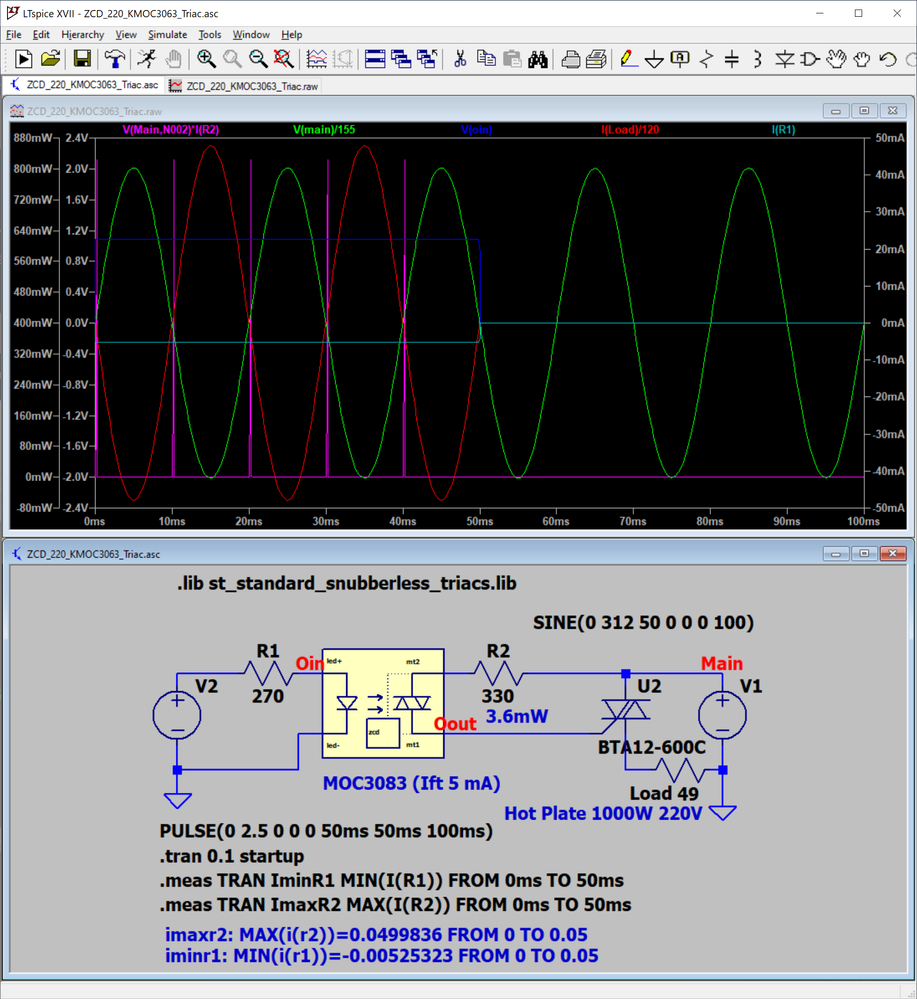

I'm not sure if I've designed the circuit for PWM power control of the hot plate correctly. The PWM output is a 3.3V MCU. I assume the PWM period 200 ms. The hot plate is 1000W, 220V, 50Hz.
