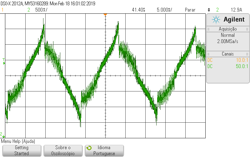

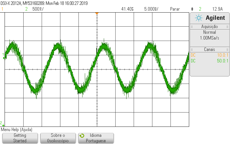

2- The motor works fine on higher speeds (above 80rpm or so). When it comes to low speeds, the current rise phase gets out of control (see attached pictures of winding current). When the speed is very low the current rises way above the programmed value, and then the falling current follows the sine waveform. What could be causing the current to not set properly during the rise phase only?
