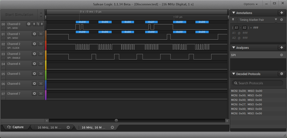

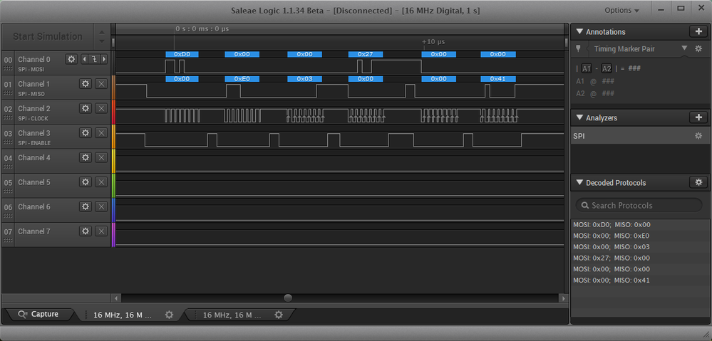

As you can see in pictures, the waveformsseem
correct
, but it does not work...With STM32F4xx StdPeriph_Driver V1.2.0
(it runs fine)With STM32CubeMX and HAL drivers
(It does not run, and MISO always returns 0x00)2015-05-20 11:22 PM
Are you sure the issue is in the firmware and not in the hardware? According to the waveforms the MOSI is ok but in some way the MISO (SDO of the L6482) is stuck low during the transmission. I see two possibilities: - The L6482 is not operative - Something (STM32?) is keeping the signal low. But in this case you'll probably damage the SDO pin of the L6482 Regards EnricoWe’re moving the ST Community to a new platform to give you a better and more reliable community experience.
