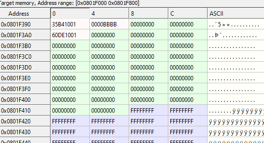

2023-01-23 5:49 AM
Hello @St�phaneM
I understand how data recovery mechanism works and need to write zeros during EE_Init at the end of the emulated EEPROM.
Is it possible to improve EE_Init routine with respect to the flash wearing of the emulated eeprom because of writing zeros on every restart?
Why it is necessary to write zeros even the eeprom variables were not modified from the last restart of the device? For example the EE_Init routine can skip Step 8 if the zeros are already there from the last restart. In this case I think it is not needed to write additional zeros at the end of the emulated eeprom as you can see on the picture above. Because the zeros are already there.
How it sounds to you?
