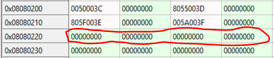

Why is this done every reset? It slowly fills up my EEPROM with 0. It happens even if page is still in Active mode and there is a plenty of space to store new data in. There was no need for transfer.
This is how my EEPROM memory looks. I have some data with data zero values in first two locations, and next two locations are all zeros. And it keeps adding all zeros after every reset.

I have noticed exactly the same issue. On each bootup and entire line of 0's is written to the page and slowly fills up the eEEPROM triggering useless switches.
2021-03-25 1:22 AM
I have noticed the same issue, too. Fortunately this behavior stops when the end of a flash page is reached (no page transfer is issued in this case).
Nevertheless this wears out the internal flash needlessly, because then a single data write of my application triggers a whole page transfer and the filling up with 0's starts again.

This write of zeros in the initialization sequence has been added in order to make the EEPROM emulation driver robust to asynchronous resets and power-downs.
During the validation of the EEPROM emulation software, we noticed that sometimes, if an external asynchronous event (reset or power-down) interrupted a Flash write operation, then this Flash line was no longer writable. Reading that Flash line gave various results including 0xFFFF FFFF FFFF FFFF which did not allow to differentiate a corrupted Flash line from an erased line by performing a simple read operation. The solution to this issue was to systematically write zeros to the first available Flash line after reset.
Note that from a theoretical standpoint, the RM0351 and RM0394 warns that “The contents of the Flash memory are not guaranteed if a device reset occurs during a Flash memory operation.�? If you can guarantee that no external event will interrupt a Flash write operation, then you can simply remove the Step 8 of EE_Init function. This the case for instance if only entering Standby mode (which controlled by the application software) generates a reset and no other external reset is possible in the application.
But , if in practice, you cannot guarantee that an external reset or power down will occur during a Flash write operation, it is better to keep Step 8 of EE_Init in order to make sure the content of the EEPROM remains always valid.
