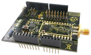

I think there's 5V vs. 3.3V problem, is that correct? Only those shields that tolerate lower voltage will work. In my opinion ST should test all interesting Arduino shields out there, and publish a list. Too bad Wish List is closed now, I would submit this request � testing of Arduino shields, like it has been done with the Adafruit TFT shield (the default firmware handles the shield).

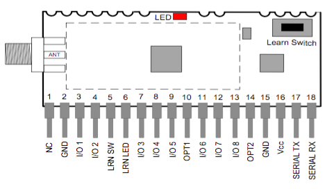

My Nucleo-F767ZI has USART (STM32F767ZIT6). Datasheet of the shield doesn't mention it. By IOREF you probably mean top-left pin ♯ 3 (or ♯ 2 if counting only Arduino pins, ♯ 1 is NC). The shield spans across that pin, but I think it doesn't use it, because on the actual interior sub-board there is rather nothing that looks like IOREF:
They put that small board on Arduino shield.
