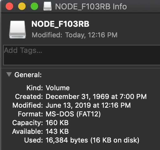

In Mac OS, it is showing the "disk" size is only 33kB instead of the normal 160kB. I tried power cycling, moving back to USB powered, removing all files (with only added up to 32kB reported in OS) and even erasing the chip with ST-Link Utility. The same message appeared. I finally programmed a 'somewhat' blank project with System Workbench which worked fine. Power cycling the device showed the full disk size back to 160kB. I switched from the onboard ST-Link (with jumpers) and back to self-powered. I programmed the device several times today and now again, I get the same out of space message.

When everything is working correctly, there is plenty of code space available and in the OS, it shows Capacity: 160KB.
When it stops working, the message shows up in the original post. When I view the OS info, it shows Capacity: 33KB. I have powered down the device, unplugged USB and the other items listed. So far only System Workbench "restores" the correct capacity.
In trying to repeat the steps that caused the problem, I think I have it figured out. The jumpers on the ST-Link don't seem to matter. If I am only using USB power, I can't get it to happen. I have to have the jumper on the E5V setting. The USB connected before external power enumerates badly and reports wrong disk size. I did try completely powering down and back up again in the correct sequence before posting but it didn't work. This condition is even noted in the Nucleo User Guide. Perhaps there is a state where the computer kept the bad information since, like you said, Mac's don't like disk drive disappearing. Either way, I can repeat the issue now and recover in one of the two methods.
