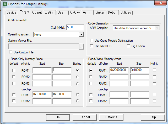

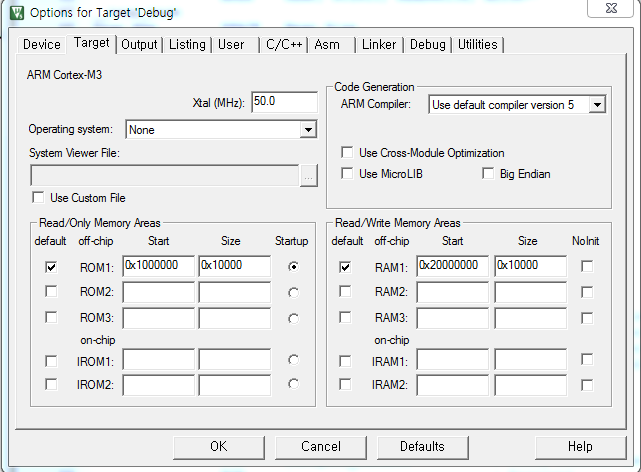

Hi.
I'm confused that KEIL MDK has 2 options as the below,
One is off-chip
The other is
I'm confused that what is the difference between Off-chip and On-chip?
#cortex-m3 #mdk #keil-mdk5

I have one more question,
I'm not sure whether do they work as the same or not, if I set the ROM1 : 0x01000000 or IROM1 :
0x01000000 ?
Posted on January 03, 2018 at 03:33
They would be very similar, if not identical, review the documentation, experiment and review the output.
