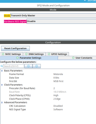

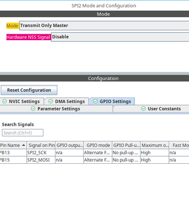

Thank you for your response. As requested, I am sharing the configuration details used in my STM32F401RE setup with the 3.5” SPI TFT Display (ILI9488). PIN CONFIGURATION
VCC - 3.3V , GND - GND , TFT_CS - PA4 (A2), TFT_DC - PA2 (D1), TFT_RST - PA1 (A1), TFT_SCK- PA5(D13)
, TFT_MOSI - PA7 (D11), TFT_MISO - PA46(D12), LED - 3.3V
BELOW I ADD SCREENSHOT OF MY IOC
