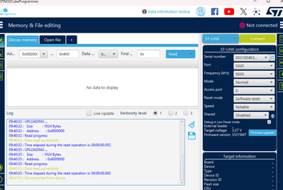

2025-06-27 2:33 AM
Yes chip is powered 3V3 externally and all the ground are common. I already try many times to program the chip using ST-LINK V2 and ST-LINK V2 IOSL but getting the same error shown in shared image.
Also I shared screenshot.
Thanks.

Show a screenshot after trying to connect with STM32CubeProgrammer.

Voltage is there. ST-Link programmer is there.
If it can't connect, a few things could be the issue:
If it has never worked, might also want to check orientation of chip and workmanship of solder joints.
