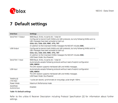

The NEO-6M should start outputting at 9600 8N1 at power up. Provided the antenna is viable and positioned to receive signals it should acquire a location within a minute or two.
2025-03-06 5:31 AM
The datasheet is your friend :
If you can live with this settings, you don't need to change anything.
Otherwise, reconfigure it at runtime.

It seem like the default settings are correct in my software. But i am not sure if the position of the antenna are critical. And i want to add extra note. When gps signal can not be active, my supply components get a litte hotter. But when gps is active, i do not observe any heating element. I am also not sure if it is coincidence or not.

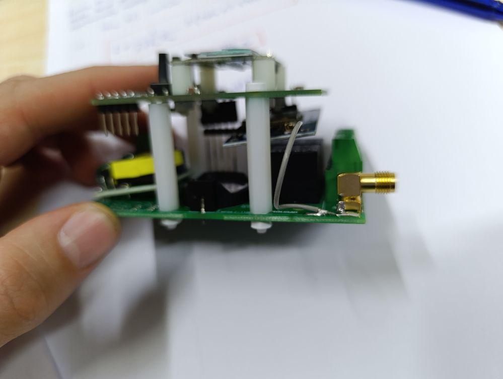

I'm not familiar with your circuit or how you have anything wired.
I'd assume you're not using the NEO-6M part directly, but on a board like the GY-GPS-NEO
I wouldn't expect anything to draw enough current to be getting hot. Perhaps measure the current?

Sorry for late reply. I did not think its due to STM32, i write it because i use that module with STM32. But you are right, it seems like something is not right about GPS module.
2025-03-11 12:45 AM
I realize that getting hotter issue is not about module,i fix my supply circuit and its ok for now.
2025-03-11 12:54 AM
And that is my module and antenna connection.
