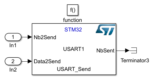

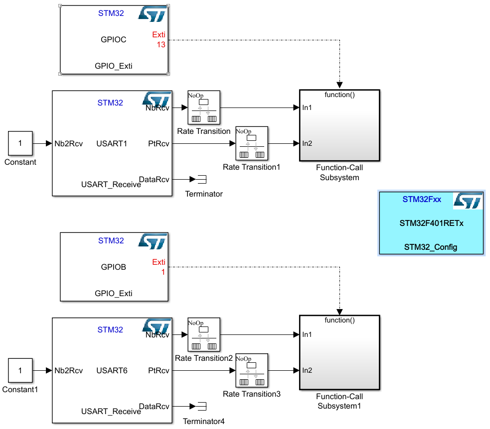

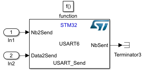

The following pictures show my Simulink model:
Unfortunately, the program only does half the job. I observe that only one USART is actually receiving anything. The other just doesn't respond when I send it a byte. Either USART works if I have just one of them in my model. But with both USARTS in my model, one will work, the other won't. It seems to be whichever USART happens to get put into receptin mode first, will be the one that's working.
Can anyone help me with a solution to this problem? Is my setup correct? Does STM32-MAT-TARGET support this kind of operation?

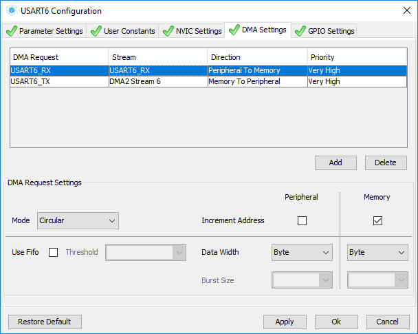

2018-09-06 3:21 AM
Thank you for the suggestion. I tried it with DMA mode.
This time I get no response at all.

2018-09-06 3:53 AM
I tried it again with low priority for the DMA channels. That didn't make a difference.
I checked and verified that the UART interrupt is enabled.

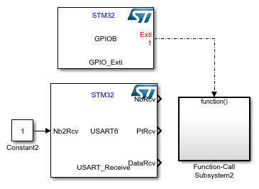

I discovered something new:
I use this minimal example for testing purposes:
This generally works. Though it doesn't work anymore when I enable the USART1 (the other USART I enabled in Cube but do not use here) interrupt.
So the issue is having two USART interrupts enabled at the same time.
