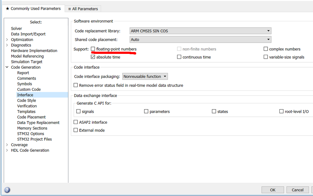

If the check box 'floating point number' is unchecked in 'Model Configuration Parameters':
the following codeto configure the system timer is still generated:

where 0.001 is the model execution time step specified in the Simulink model.
