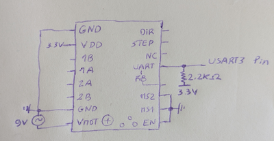

I'm working on a project using STM32U5 and I'm trying to communicate with a TMC2209 stepper driver over UART in single-wire (half-duplex) mode. This is the connections:
In order to test the connection I'm trying to read the IFCNT values of the driver, which is the register in TMC2209 frame counter used to track how many valid UART datagrams the driver has received since power-on. This is my code:

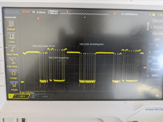

This is the full output
    Starting...
    TX complete
    Received complete!
    0x05 0x00 0x02 0x8F 0x05 0xFF 0x02 0x00
    CRC mismatch: got 0x00, expected 0xAE
    Initial IFCNT: 252
    Writing to reg 0x10: 0x05 0x00 0x90 0x00 0x00 0x00 0x00 0x50
    TX complete
    TX complete
This is the osciloscope result
