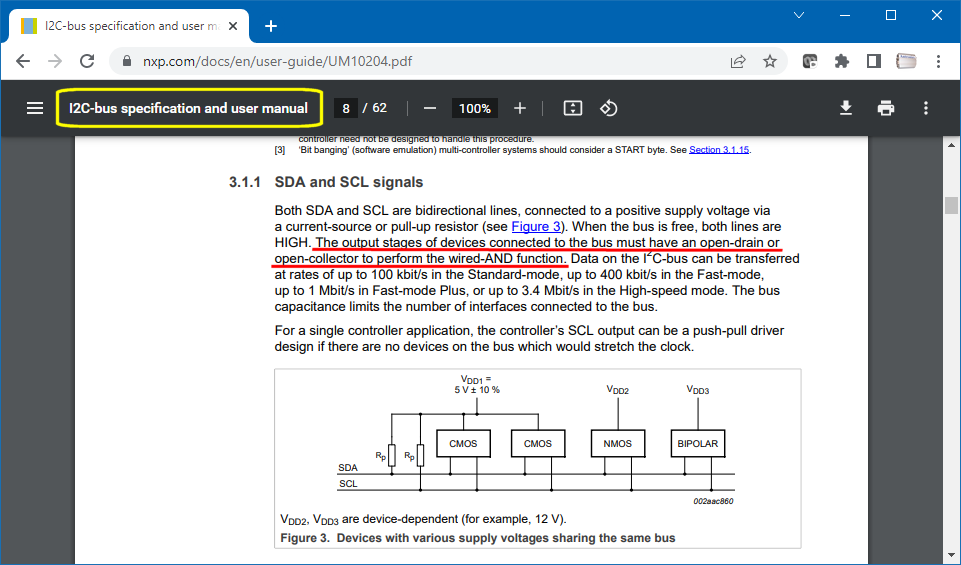

"Our Technical Director mentioned that to comply with the I2C standard and allow for multi-master mode, both SCL and SDA should both be open-drain"
He is correct - the specification demands it:

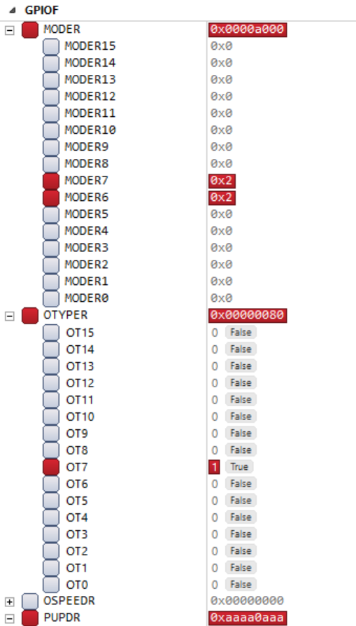

GPIO_OTYPER is definitely set to push-pull:

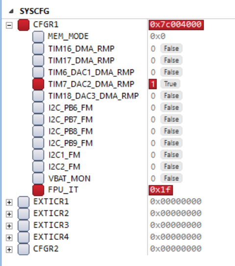

And SYSCFG_CFGR1 looks like this:
We haven't enabled Fast Mode or Fast Mode Plus. I wonder if that would make a difference?
