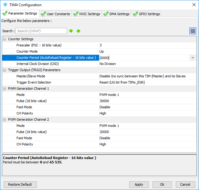

(Russian)) is to use PWM timer with DMA.So, currently, I'm trying to start properly work of led on stm32f4discovery in the following way:
- I used timer TIM4 with PWM on channel 1 (PD12 pin)

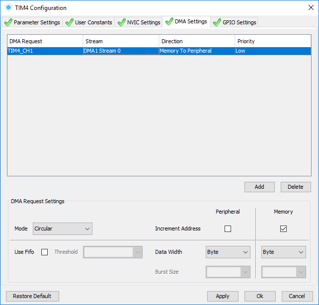

- I configured DMA by next way
- I created buffer with data to compare in timer and transmitted it to properly register

Your using uint32_t buffer. Try changing the data width on DMA config dialog from Byte to WORD.

Make the data width change and try this;

Your output will start high with your initial channel1 pulse setting of 30000.
If you set that initial value to 0, the cycle will start up cleanly.
