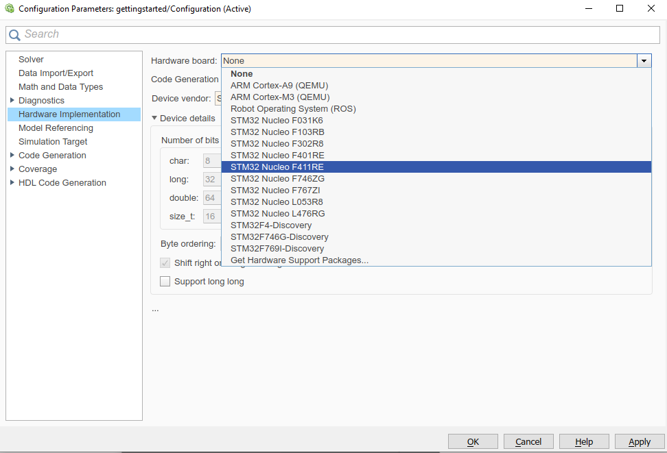

After having installed both hardware packages provided by Mathworks coder embedded team:
and while was creating a new model-based design I wasn't able to configure the necessary hardware implementation because there is no STM32 Nucleo H7A3ZI-Q that can be found in the drop-down menu as follow:
So I have been wondering if there is another way to cope with this matter or perhaps
better to buy a new board because mine (H7) isn't supported at all and if not that would be ashamed:relieved_face: .

I got the confirmation that Matlab Simulink maintenance and support are ensured by MathWorks.
You need to refer to their website and ask for the support directly by MathWorks in order to know their planning for the support of new products other than what is listed here.
