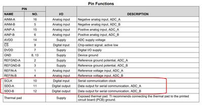

In SPI terms, Looks like it has a single SCLK, two MISOs, and no MOSI:

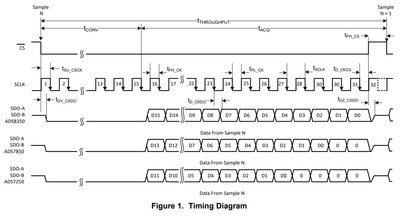

So the start of the read is triggered purely by /CS:

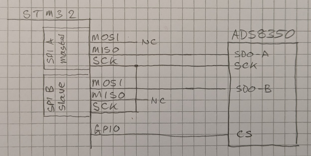

So maybe try:
You'll need to manually control /CS anyhow to get the tCONV timing
PS:
You may also need to feed the /CS back into the Slave...

I would think not: there should be just one /CS - that's what synchronises everything.
Looking at it again, it seems that tCONV isn't (just) a time - it's a number of clock cycles.
You should be able to get that by the Master clocking-out a 16-bit value (just a dummy that gets ignored).

You could still try the Master + Slave, and get the Master to give the 16 clocks as suggested?
Should be easy enough to try ...

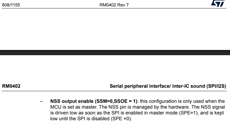

The F4 does have a kind of hardware /CS control:
Maybe that could be made to work?

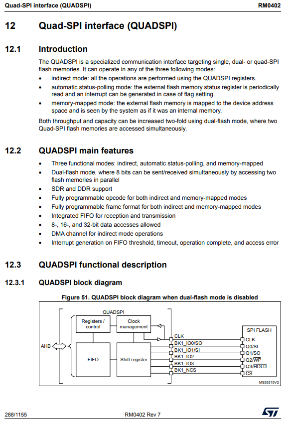

There's also QUADSPI ...
