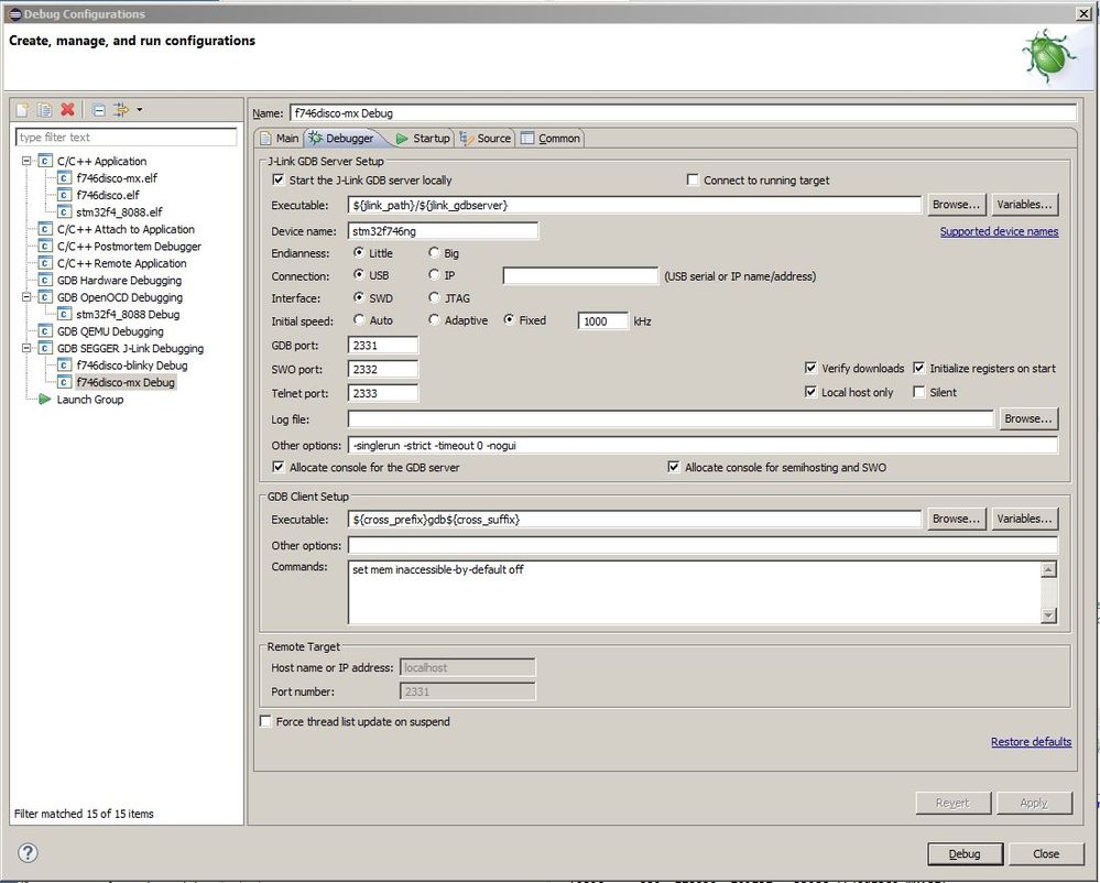

I'm glad to see that many people have had success in fixing this based on the Segger J-Link mod. I have come back to this myself, having worked along just using ctrl-r to run to cursor locations in the source code to avoid the problem.
However, when I install the J-Link firmware on my discovery board, the install works however the IDE needs some help to use it. I am using the AC-6 SW4STM32 free IDE which works quite well as an un-restricted development environment. However since it is essentially Eclipse pre-configured for ST's chips it does not have all of the ARM tools installed that would support other vendors chips as well as other vendors tools. Specifically it does not have the plugins installed that would be aware of a J-Link as a debug connection. It only has the ST-Link option for the 746 disco board.
I have started the process of adding the missing pieces but am still not quite there.
Has anyone out there done this using this tool chain? Specifically the SW4STM32 IDE? If so, did you do something specifically to enable the J-Link interface? If not, I will post my process once I get it working.
Thanks.
2017-04-21 9:06 AM
To use this updated J-Link firmware I bit the bullet and switched from SW4STM32 IDE to a regular Eclipse/CDT with the ARM plug-in.
And then I used this:
http://gnuarmeclipse.github.io/debug/jlink/
Had to change a lot of stuff to make the CubeMX project work there, but I was more interested in seeing if the new debugger would work. Planning to try to get the J-Link working in SW4 but haven't looked into it yet.
2017-04-21 10:07 AM
Thanks, William. It's good to at least hear others have seen the same issue and confirm that I am not just chasing ghosts. I've installed the J-link plugin into SW4STM32 so I can find the J-link as an available debig profile, but it still is not quite there. I'm getting a gdb --version error. I'm currently in the process of adding the ARM packages to SW4STM32 and I'll post what I did if I am able to get it running.
2017-04-21 1:07 PM
Aaron,
I get that error gbd --version also, if I simply click the Debug icon.
I select from the dropdown the debug config itself (which I would think does the same thing), and then it just works.
Bill

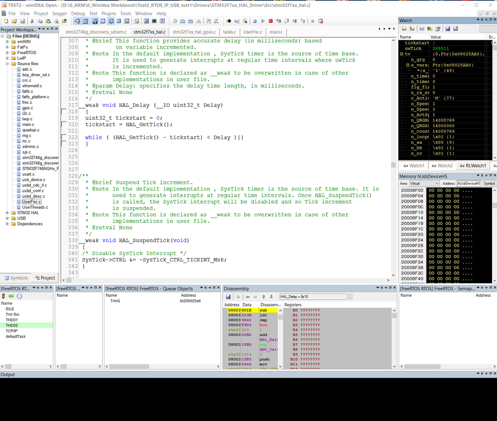

Why you do the rumble of configure the IDE instead using a full featured working one line
http://www.isystem.com/download/winideaopen
?It supports ST-Link and J-LINK, a bunch of RTOS liek freeRTOS, RTX and others. here an examples of my actual project of an F7DISCO board using an CubeMX generated freeRTOS project
