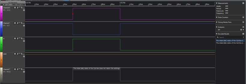

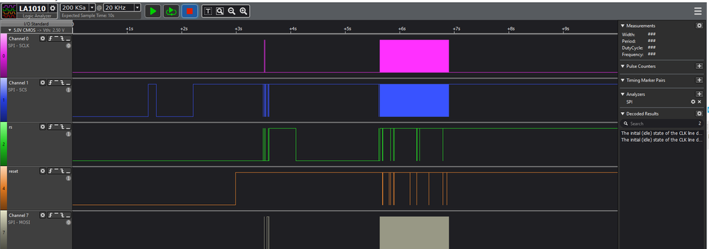

I am trying to connect an ILI9325C display to an STM32F401RET6 microcontroller. After writing the code correctly and connecting the display, it doesn't respond and only has the backlight on (from the power supply). I connected the STM32 to a logic analyzer and started an SPI analysis. I configured the CPHA and CPOL settings to match those of the STM32, but I keep getting the error: "The initial (idle) state of the CLK line does not match the settings." This error occurs during every test.
However, during one of the tests, I saw something start to display, some commands coming from MISO, but it was only once, and the display still didn't react.
I would appreciate any help since I have been working on this for a total of 20 hours.

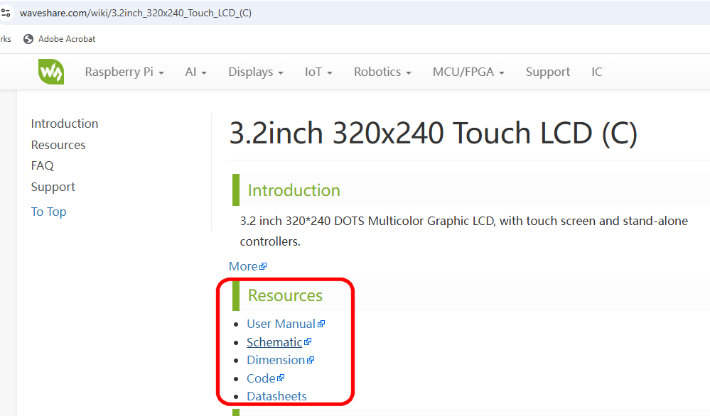

1. Here is the link to my display: 3.2 inch 320x240 Touch LCD (C)

5. and i am also attaching photos from the analyzer:

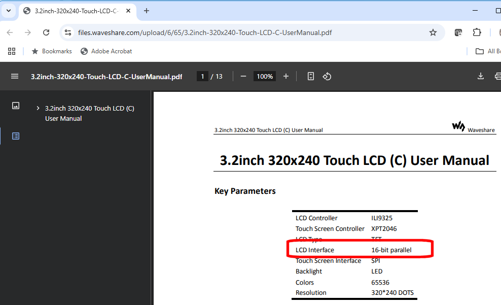

RobK1
Senior II
Well, I hate to tell you this, but your display is not SPI, but 16-bit parallel.
The SPI is used to read out the touchscreen data.
Indeed:
@kiwiosek2007 the datasheet is available from the page you linked:
https://files.waveshare.com/upload/6/65/3.2inch-320x240-Touch-LCD-C-UserManual.pdf
See also the schematics linked from that page.
There is also code:
Litterally I have to missed that. Thanks for the hint. @RobK1 @Andrew Neil
