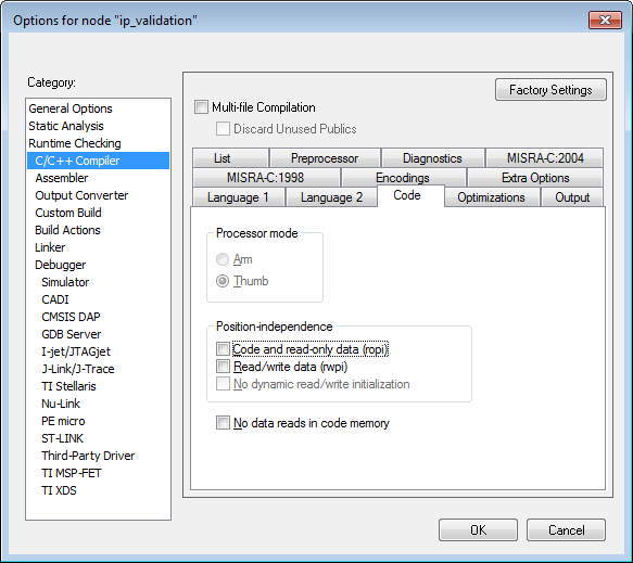

In IAR I'd expect a check box item for compiler/linker to generate position independent code. Check the documentation and support materials, surely covered.

Options / C/C++ Compiler / Code / Position-independence
2019-03-28 6:00 AM
I already activated this option , i still have the problem how the IVECT table be relocatable ?
