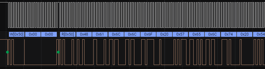

I appended two screenshots of the I2C SCL and SDA lines.
The first Screenshot shows an read cycle directly called after writing into the EEPROM.

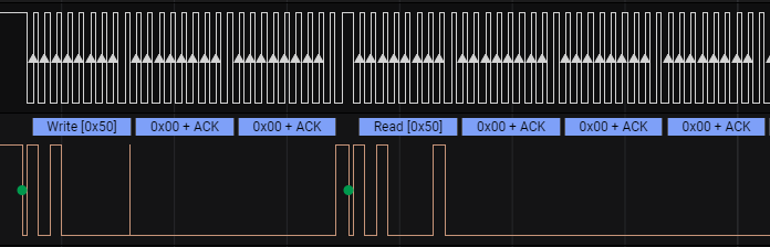

The second one shows a read cycle called 1 second after the first screenshot (or directly independently of the first one).
When reading directly after a write cycle i get valid data, when reading independantly I only get back zeros.

2021-09-06 6:32 AM
Found the problem. I accidently overwrote the EEPROM Space after the direct Read after writing.
