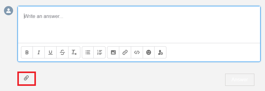

2023-05-02 8:44 AM - edited 2023-11-20 6:43 AM
Hi @DRobe.4 ,
you can add your project in the comment with .zip extension by clicking on this icon (as shown the below figure.
Kaouthar
