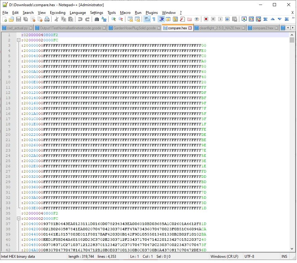

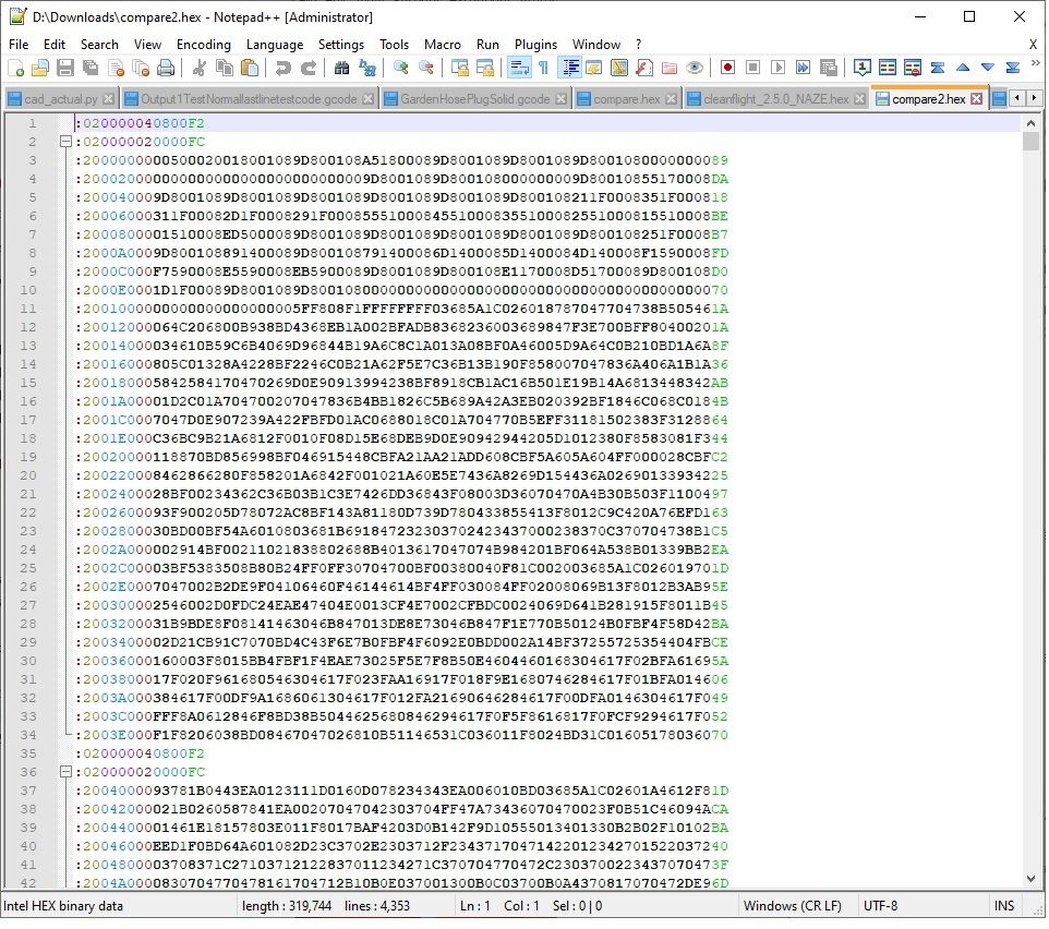

@Community member Yes I can view and compare the program before and after reboot at address 0x08000000
Before and after reboot:

Change the first few bytes right at 0x08000000 to 0xFF (to prevent the code from doing anything useful), then reset, and see if the entire page 0 is still reset or not.
