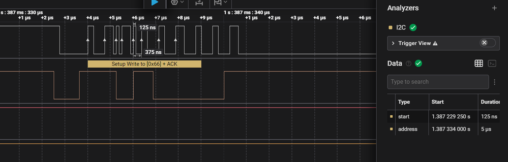

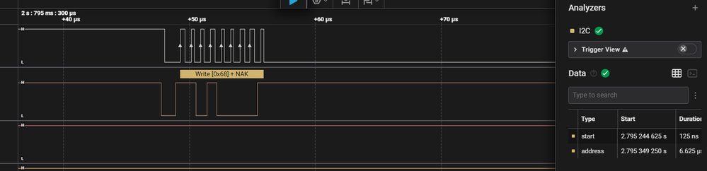

The problem I'm facing now is that it seems like the thing stopped working when it after calling LL_I2C_TransmitData8 and it just stuck waiting for the ADDR bit to be set but that never happened. The logic shows that it generated the start correctly but the address is very inconsistent when I test it by resetting it
Sometimes it generated the correct address, sometimes SCL goes high at the same time as SDA. I've tried changing the I2C speed configuration but sometimes it makes worse where SCL can't even transfer a bit.

@Billy1 wrote:The logic [analyser?] shows that it generated the start correctly but the address is very inconsistent
Have you looked at the lines with an oscilloscope?
A logic analyser assumes that you have good, clean digital signals - a scope will show if that assumption is true or not ...
2025-06-13 6:09 AM
Take an analog capture and ensure the edges are clean enough.
Are external pullup resistors in the 2.2 kOhm range present?
