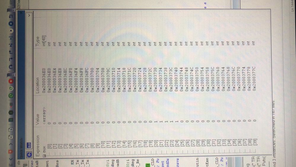

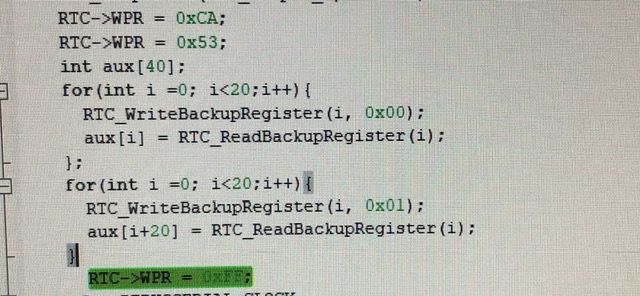

The first one is caused by a non writing of the RTC backup register. As shows the example below:
As we can see, in the STM32L151RBT6A I can't write from the backup registers with address 0x40002864 forward, problem that doesn't happen in the STM32L151RBT6 Version. Following the datasheet, we can see that the new version has 20 thirty-two bits backup registers. There is any assumption why i can't use all of them? Just the first 5 ones and without change any configuration, the forward register is not writable? There is any division between the first 5 backup registers and the others 15?
