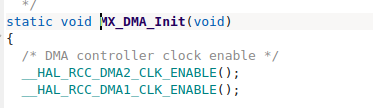

Very interesting but I solved.
Boot code does not include any DMA process but If I enable DMA clocks before the jump User App,
User App working correctly, If I disable this clocks before jump I get same error.
What is this situation reason, Does DMA only get clocks in start address (0x0800000) ?
