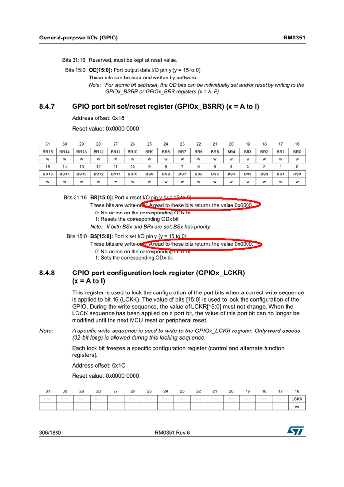

I am using an STM32L4 MCU and IAR Embedded Workbench. I noted that when I start a debug session in the register window the "write-only" bits of a certain register are field with the letter "w" (for example in GPIOx_BSRR). I was wondering if this is the behavior just in the IAR debugger or it happens for other debuggers as well and is there a way to watch these bits in particular when they are written or not.

Thanks but I have already read that! that should be clear from the question and answers.
The question is: when these bits are "written" is there a way that the debugger shows a change of state or something like that? Does it depend on the debugger ?
